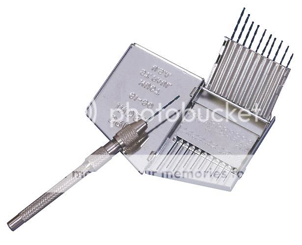

Well, if you DO decide to peg it, I wouldn't use any kind of power tool.
Go to a well-stocked hobby store and get yourself a pin vise.
It's a small manual tool that modelers use to drill holes. It works well on resin and you'll have much more control.
A pin vise with an assortment of small bits is fairly inexpensive.

Default Bowen Super Skrull repair
Tools
Pin vise (two bits)
Brass rod (1/2-9/16 of an inch long)
Sandpaper (if needed to sand down) or something to add texture to the surface
Two-Part Epoxy (Loctite instant mix 5 minute setting time)
Quick Rundown
-Sand each end to fix fit/gap or simply add texture to the surface
-Cut a piece of rod about 1/2-9/16 of an inch
-Mark rod with felt tip pen at halfway point
-Drill down part of the way with the smaller bit for the pilot hole (hand and arm)
-Drill down rest of the way (1/4 inch or so) with the larger bit for the final hole, periodically measuring with the rod (hand and arm) *larger bit should be slightly larger than rod to allow for some wiggle room
-Once rod sits in the hole at the halfway mark, get ready for two-part epoxy
-Apply epoxy to half of rod and insert epoxied half into arm
-Put hand portion over the rod and line up/position with arm
-Pull hand off and let epoxy dry
-Apply epoxy to surfaces surrounding both holes and half of rod that will insert into hand
-Put hand portion back on rod and line up/position with arm
-Find something to hold it in place while it dries (rubber band, piece of packing peanut for example) (takes 24 hours or so)
-Enjoy!
Long overdue update on this. So, I did go the pin route. I kept thinking I should take pictures for visual reference, but... Anyway, I used the pin vise and technique that TF and H suggested. For the pin/rod...I'll call it a rod...I cut a section about 1/2-9/16 of an inch long off of a thin brass rod (since brass doesn't rust) (not sure on the diameter). I say 1/2-9/16 because I believe the one I used was slightly shorter than the one I have on hand which is 9/16.
Before I did any drilling or epoxying I had to sand each end to 1. give it some texture for the glue to 'grab' onto and 2. fix the fit to make sure there wasn't a significant gap. (I only sanded the arm portion for texture. I sanded down the hand portion since the break occurred inside the arm, leaving material to work with.) Going in I thought if it's a clean break (no missing pieces) then the glove should fit flush against the arm...not the case in this instance. You can use thick or fine grain...thick allowing you to shave down quickly and fine allowing you to work on it without worrying about shaving too much. I used both. Remember to periodically test the fit. You don't want to spend all that time sanding just to realize you've sanded too much and now the ends don't meet. It's a little tedious, but worth it imo.
When it was time to drill, I marked the rod with a pen at the half-way point and used it to measure how deep I was drilling. First off, when it came to drilling, I used two drill bits. One (smaller bit) for the 'pilot hole' and one (larger bit) for the final hole. The pilot hole simply serves as a guide and makes it easier for the larger bit to drill down since there's less material to drill through. The smaller bit may be more forgiving, but it's important to make sure you drill at the appropriate angle. You don't want to get going and realize you're about to start drilling through the side of the arm or leave the rod at an odd angle.
So, after marking the rod I then took the smaller drill bit and hand drilled down about half the length of what would be the final hole. Once that was done, I took the larger bit and drilled down about a quarter inch into the arm (half the length of the rod) and a quarter inch into the hand, periodically inserting the rod into whichever hole I was drilling (there's many ) to check the depth. Once it reached the half-way mark on the rod, I was good. I don't remember the size of the larger bit I used, but it was slightly larger than the rod to allow just a little wiggle room. Also, just a note, after every few turns with the drill I would take it out and blow/pick out the excess resin as to not pack it into the hole when I inserted the rod.
With the drilling out of the way, I covered the half of the rod I was going to stick in the arm with two part epoxy (Loctite instant mix 5 minute setting time). I inserted it into the arm, then fit the hand over the other half of the rod and lined it up to make sure I had the positioning and fit correct. I then removed the hand, keeping the rod in the arm, and let the epoxy dry.
Now, with the rod firmly in place, I applied epoxy to the area surrounding each hole and to the half of the rod that would go into the hand. I then fit the hand piece over the rod and positioned it to make sure I had the fit right. Once I had done this it was time to find a way to hold it together while the epoxy dried. This can take somewhere around 24 hours for the strongest hold.
Pretty simple solution is a rubber band (not too big, not too small) wrapped around the fingers or flame and the curve of the arm...what would probably be considered the elbow area. When I did this I noticed the arm would tilt towards the shoulder, creating a gap at the break. An easy remedy, naturally, is to fill the empty space between the hand and the shoulder. Something small and soft like a little piece of a packing peanut works well (you might have to flatten it a little). You don't want something so big that it pushes the hand outward...then you have the same problem on the other side. So, just something big enough to fit the gap and malleable enough to not risk the paint. After a day or two it should have a nice hold.
It might take a go or two...the first time I did this I didn't feel I had it as flush as it could've been. It didn't feel like a strong fit and there was a little more gap than I liked. So, I re-broke, sanded/removed the glue and re-fit it. Now it's a strong fix...very solid. Not a whole lot of gap, either.
Anyway...not as quick a fix as simply gluing it, but I think the added support and peace of mind that comes with it is worth it. Hopefully this helps if anyone else ever runs across this problem. Some pics below...
